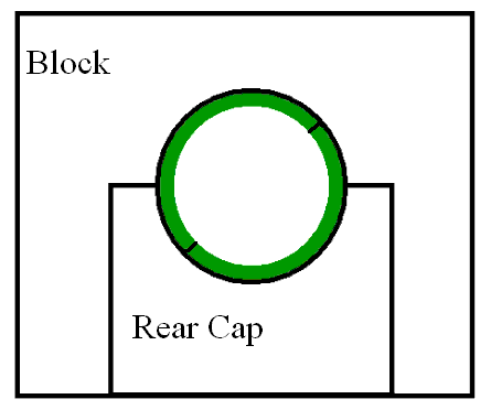

  10. Remove the neoprene seal from the package and apply a thin coat of rtv to the back side of the seal MAKE SURE THE SEAL IS INSTALLED WITH THE LIP FACING INSIDE THE MOTOR.
    Slide one half of the seal up into the grove between the crank and the block until there is about 2 inches hanging out. Now you take the other half of the seal and slid it into the groove between the crank and block from the other side. Now you should have the two pieces meeting each other closer to one side on the bottom of the crank.
    Cover the top of the cap with a tin coat of rtv. Slide the rear main cap carefully up into the block and ensure with a flashlight that the seal is seated into the groove in the cap then put the 2 bolts in and turn them in by hand
    Note: the green is the seal and you can see the black representing where the two halves meet (if you do it this way then it won’t leak at the intersection between the cap and block)
